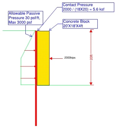

Hi fellows,
I am working on project that requires a design for jacking and receiving pit. I have no problem designing the retaining wall to resist the active load and reach bottom of the pit. The problem is the jacking load is 2,000 kips. The maximum concrete block we can install is 18ft X 20ft and the maximum passive pressure that the geotech has recommended is 3000 psf max. When you do the math there is 2.6 ksf (2000kip/18X20 - 3 ksf)of pressure remains to be resisted by retaining wall. The way I design it, I use LPILE and distributed load to come up with a CIDH design. The problem is the CIDH is like 4ft DIA. @ 5 ft OC. and even with maximum reinforcement the deflection is excessive. Any recommendation on how to design jacking pit with such a huge load?

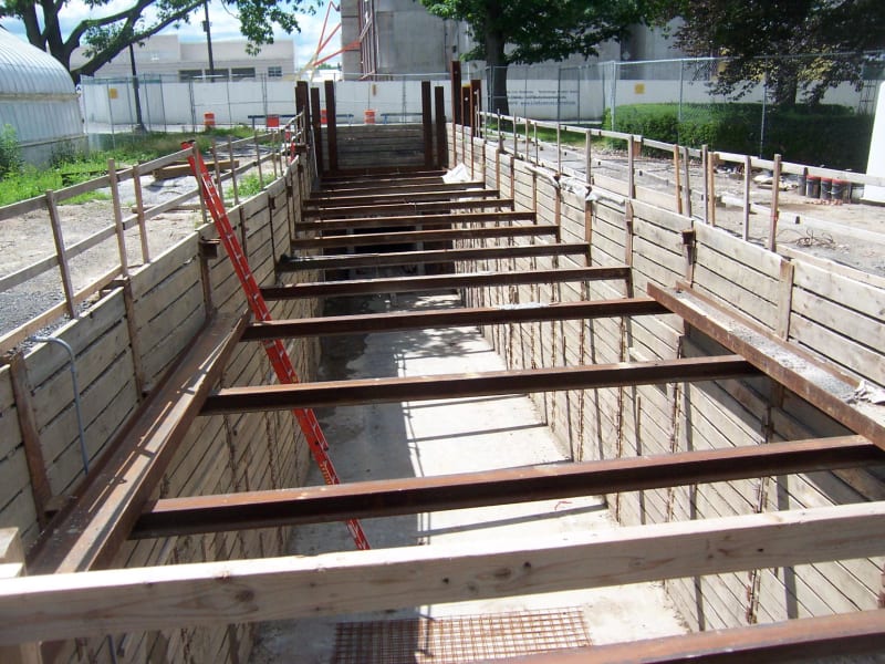

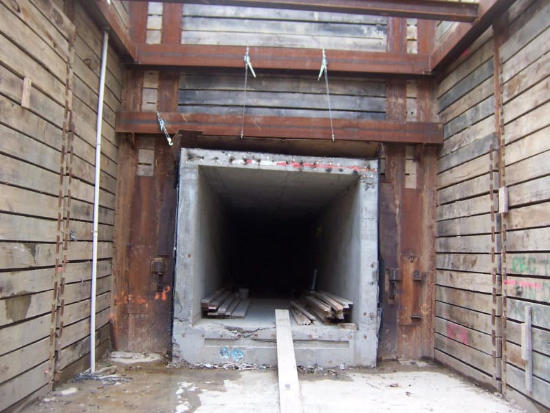

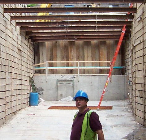

babibibak, I designed a jacking pit for pushing a C-I-P concrete pedestrian tunnel under an active road at an Ivy league University. The jacking force was 2,500 kips. The jacking pit was 120' long by 21' wide by 21' deep. Three of the pit's sides were soldier beams with timber lagging with steel cross braces between opposite soldier beams. For the jacking block end of the pit, I designed a double thick, end wall of PZ27 SSP. In front of the SSP end wall, I designed a reinforced concrete jacking block that was 21' wide by 10' high by 4' thick. The bottom of the concrete block was buried about 2 feet below a poured concrete slab upon which the tunnel was constructed prior to jacking. The tunnel was pushed across the top of the greased-up slab. In front of the concrete block, I designed a double layer of 33" x 66" x 1.25" thick steel plates to distribute the force of the jack pistons to the concrete block. As an extra stiffening measure, the contractor added 2 each, HP12x74 soldier beams behind the SSP end wall (he was worried!). The pit and jacking block worked fine. Here are a few photos:

Here is how I see the forces to design the wall. As I said the residual force after I deduct the allowable passive pressure is huge. Even 4 ft CIDH @ 5ft O.C. give me significant deflection (14 in.). I don't know how a sheet pile can resist this load.

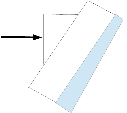

Can you reach out to your geotechnical engineer, see what his opinion on the concrete block lay on an inclined ground. I wonder if the earth pressure will increase significantly, and settlement become less a problem.
babibibak, the double SSP is just one wall of SSP driven as close as possible to the other with little to no space between each line of SSP. S = 30.2 in[sup]3[/sup]/lf x 2 each = 60.4 in[sup]3[/sup]/lf. My SSP was 30' long. I designed for both a triangular and a trapezoidal passive pressure distribution behind the SSP. The maximum trapezoidal pressure magnitude that I used was 6.25 ksf. 2500 kips / 20' long wall = 125 klf. The flat portion of the trapezoid was 10' to match the height of the concrete block. I assumed 10' sloped pressure above and below the flat portion. Therefore the magnitude of the trapezoid was P = 125 klf / ((10' + 10')/2) + 10' = 6.25 ksf.
When I checked the required depth of the SSP to provide the passive resistance (with a FS = 1.5), I needed a 23' long SSP . I used 30' long SSP.
I checked the bending moment of the SSP for the trapezoid pressure distribution and the theoretical triangular pressure distribution.
I used a Coulomb passive earth pressure coefficient with wall friction = 0.5Phi.
I don't think you will find this method in any text book. But it worked fine for the 2,500 kip jacking load.

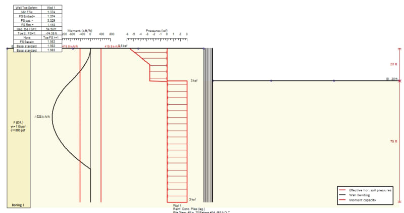

The geotech report specifically says use maximum 3000 psf of passive to resist jacking load. Below is the design. The moment is 1530 kip-ft/ft and embedment is 75 ft. Is there something I am missing?
Get a new Geotech. Geotechs are too often against taking ANY risks. Their recommended numbers are too often padded for conservatism. Calculate your own passive resistance. Use reasonable soil properties. My soil properties weren't much different from yours if you used drained properties where c = 0 and Phi = about 32 degrees (check your PI to get an approximate drained Phi angle) Don't analyze this as a wall. Look at it like a deadman. I used drained conditions with unit wt. = 125, c = o, Phi = 32 degrees, and delta = 16 degrees. Don't use a Rankine passive earth pressure coefficient. Check the 3,000 psf maximum passive resistance. p[sub]p[/sub] = gamma x K[sub]p[/sub] x D = 3000 = 115 x K[sub]p[/sub] x 20'. Therefore, K[sub]p[/sub] = 1.3. What safety factor is the Geotech applying to the K[sub]p[/sub]? Is this soil like toothpaste? Get rid of the safety factor on K[sub]p[/sub]. Put the safety factor on your jacking load (I hope there isn't already a FS on the 2000 kip load and on the K[sub]p[/sub]). Find the embedment depth you need.

OG, the portion of the tunnel that got jacked was built in the long sheeted and cross-braced trench. The jacked tunnel was built on a down sloping, greased, concrete slab to help reduce friction. The tunnel was then jacked under the road (reportedly to within a half inch of its planned final location). After the tunnel was jacked, the end wall with the concrete block, SSP, and 2 soldier beams was removed and the sheeted trench was extended back to the building (for which I had to design pit underpinning and needle beam underpinning). Then, about 220 LF of C-I-P concrete pedestrian tunnel was built from the end of the jacked section back to the building that was behind the jacking reaction block. The surplus excavated soil was trucked off site, keeping just enough to backfill the tunnel in the trench.

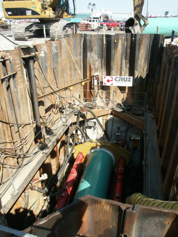

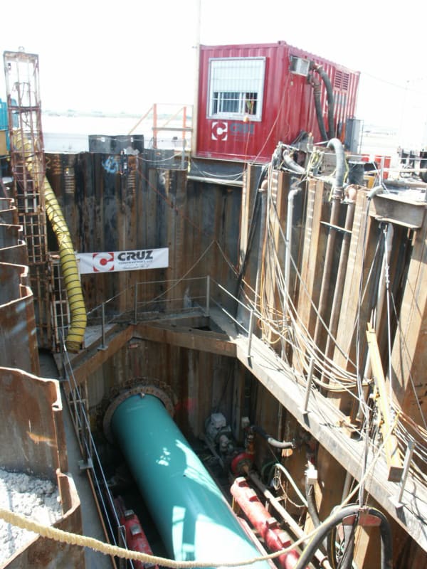

babibibak, just so you don't think that I was lucky that the above, Ivy League, jacking pit and reaction blocked worked, I also designed two more, internally braced SSP jacking pits in predominately soft organic silt at Philadelphia International Airport for jacking 60" diameter casing pipes under a paved runway and a taxiway. I used the same design method as I described for the above Ivy League university project. Pit #1 was 37.5'L x 20.83'W x 20'D with PZC 18 sheets, 36' long. The design jacking force was 714 kips including a safety factor of 2. The Pit #1 end wall was a single SSP wall. Pit #2 was 36.75'L x 18.37'W x 26.5'D with NZ 26 SSP, 50'long. The design jacking force was 1970 kips including a FS = 2. The Pit #2 end wall was a double SSP wall. Both pits, supported 0' to 5' of silt fill soil over deep silt with N = 1 or 2 to mostly WOH. Ground water was assumed to be 5' below original grade, the top of the SSP walls. For Pit #1 the reinforced concrete reaction block was 20.83'L x 10'H x 3'T. For Pit#2, the concrete block was 18.37'L x 10'H x 3'T. For the soils, I used 115 pcf saturated, 53 pcf buoyant, 26 degree Phi, and 13 degrees wall friction.These pits worked fine also.
PEinc Thank you so much for sharing these incredible photos from projects you have designed. I have no doubt that it wasn't luck. I think I figured out what I was missing. The passive pressure width can be twice the width of the retaining wall. Therefore, the resisting force in my case, even with Max. 3 ksf of passive, become 1800 kip. So, there is only 200 kip remaining to be resisted by wall and embedment. Thanks everyone, especially you PEinc, for sharing your opinion.
