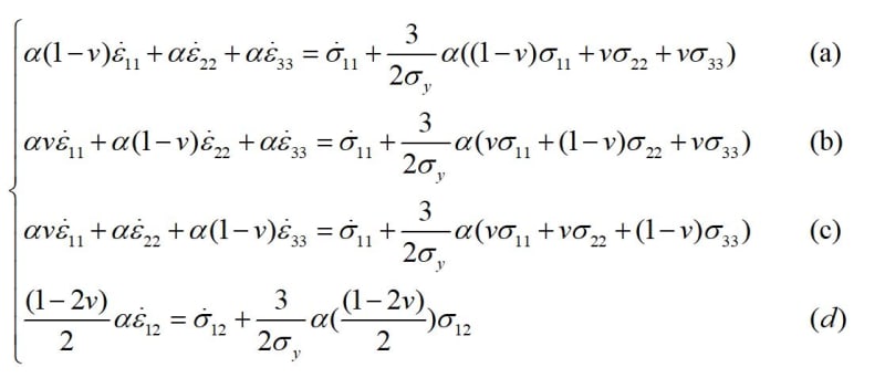

you have right L-1 is a fourth-order tensor. I would be so thankful if you can verify if this I write is correct.
I multiply the équation above by the fourth-order tensor L (Hooke's law), my problem is 2D so :
I found the equation system (a, b, c, d) below, alpha and nu are constant:

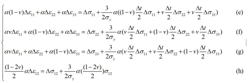

Then I use the example you have sent to me and I obtain the equation system(e,f, g, h):
but how I can obtain the DDSDDE?

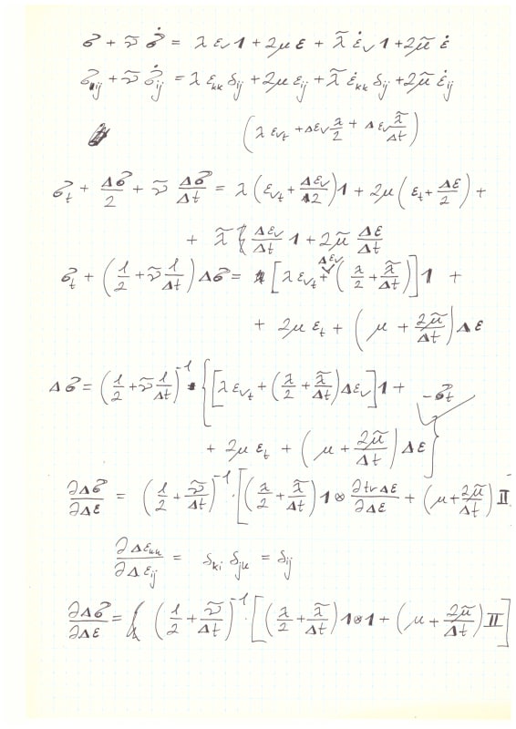

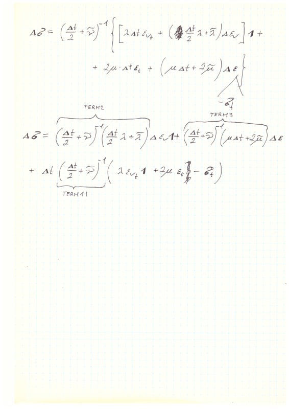

Unfortunatelly, in order to check your derivations I would have to make some derivations myself. I don't want to do that, because I'm a little bit pressed for time. However, I uploaded some derivations which I did in the past for the case discussed in the UMAT tutorial included in Abaqus manual. These derivations might be of some use to you. I prefer to use tensor notation (instead of the index notation).
Note that in your case DDSDDE is a 6x6 matrix. It is symmetric and probably many of its components will be zero. It depends on the specific form of the fourth order tensor L.
