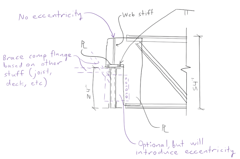

I'd be tempted to replace the 24" girder with a dropped, 24" wide flange that either needs no additional bracing or just some intermittent discrete bracing (not the roof deck).

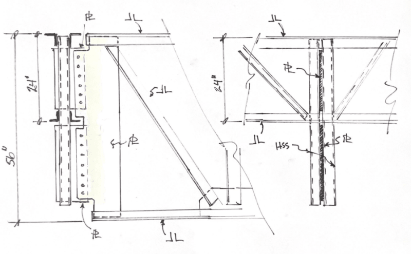

As others have noted, there may be more favorable framing options that could simplify this. Below is a possible solution - essentially building a beam web into each member. Deep bolt group to handle the eccentricity and good engagement of the top and bottom chords of the 56" deep truss.
@CANPRO That's a fantastic idea, I was only thinking about the top part of the plate. This will solve shear problems at the connection. Thanks for the sketch, you helped more than OP. I'm going to use this idea for similar situations.
Here's an idea using KootK's dropped girder but eliminating eccentricity:
