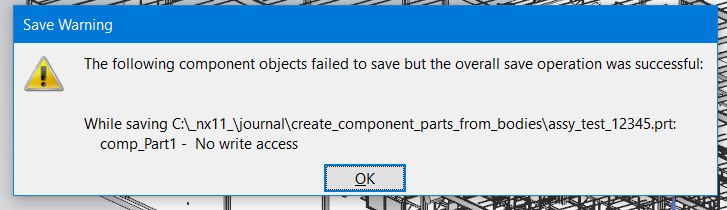

Journal work ok but error when saving the assembly part
Ehaviv
Computer
Jul 2, 2003
1,012
IL
Hi
This journal is based on a gtac example.
its work ok the component is built but problem when
saving the parent part.
Thank you.

In native mode nx11
OK fullpath resolv the problem
ufs.Assem.CreateComponentPart(wp.Tag, _
"C:\_nx11_\journal\create_component_parts_from_bodies\comp_Part6.prt", _

This journal move bodies to a component.
I look for a way to copy bodies to a
New part without impact the original
Bodies part.
If someone has any ideas.
Thank you.
The "CreateNewComponentBuilder" has an option to delete or keep the bodies. I suggest recording a journal while using the "create new component" command.
www.nxjournaling.com
Hi Cowski thank you.
I'll record and try this.
Thank you.
