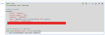

  1. The header in the calculation sheet is filled out using a small code cell at the start of the notebook (image below). This creates a small .json file that is stored in your project folder. Once that is created you do not need the code any longer unless you want to change it or use different project headings. In the example image you can see I was adding metadata to the project file. I tested that to see if I could get that to work, but I found the simple file was easier with the output I wanted.

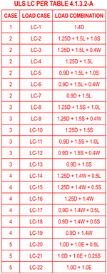

Ok, too much work. Some of this is a bit over the top. It is my way to test ideas. I will share a simple problem I was working on last night that all us bright people can figure out. I am moving on to the load cases now. I was working on this a bit last night. To think thru the steps I opened my code book. As I was looking at the table I wondered if I could code the table. Sure could and it was easy. I grabbed a .pdf screen shot of the table, and in about 5 minutes I re-created Table 4.1.3.2 using AI. The table is exceedingly similar to the table from the code. That does use my table function. Next, I wondered, hmm, can I create all the load cases in the same basic format to use for my code cells? Yes, in another 10minutes I had that too. I sitll need to check that, but it is a great start I think. All of this information is in a data frame that can be accessed later in the code. One can easily parse cases if your problem does not include all the load patterns.
