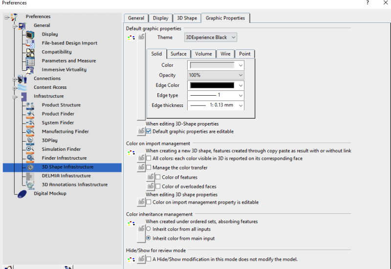

I suggest you play with the following settings...
Eric N.
Got it, try this:

@itsmyjob that works perfectly, except I would like to keep from forcing all the other users change their settings when using this macro.
@Little Cthulhu I will have to play with that in my code for future uses.
I believe I figured it out after searching long enough.

if you want to use the settings, have the macro read them when the it starts , then set them for the copy/paste, then put them back to before macro state...
Eric N.
That's a good idea, I had not thought about it.
My code works the way i needed it, just had to figure out how to select the part prior to pasting to keep the color the original body had.
