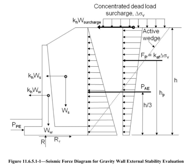

Thank you! I think my confusion is that I was looking at the fill on top of the heel and thinking kh and kae are applied to it. when only kh is applied to this fill while the lateral earth pressue due to seismic is applied to the wedge behind the boundaries of the retaining wall.
hmmm, can you post a sketch as to what you mean exactly.
The weight of the fill should also be considered as part of the weight that is applied to the wall. Seismic or not....
Kh is the horizontal seismic acceleration.
This is applied to both the soil and the wall. The red hatch you have shown is soil above the heel, I would consider this as part of the "wall".
kh is applied to the active soil wedge also, this is your blue hatch.

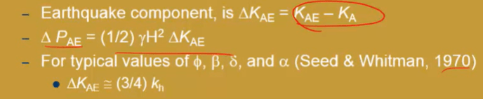

Kae is the seismic earth pressure and the static earth pressure.
ΔKae is the seismic earth pressure only.
ΔKae is approx 3/4kh for typical walls and soils.

I did look at the lecture, seems I didn't understand, so what you are saying is that the kh is integral of Kae? meaning it is still inertia force but only for soil which we happen to take 3/4 of it, but if we are looking the soil above heel, we are fully considering the kh, correct?
kh is nothing more than the horizontal acceleration. This is in units of gravity. Some people, conservatively, take it as Peak Ground Acceleration (PGA). Some take it as half to 2/3rd of PGA. There is no universal guidance on this. Many codes have different values to take.

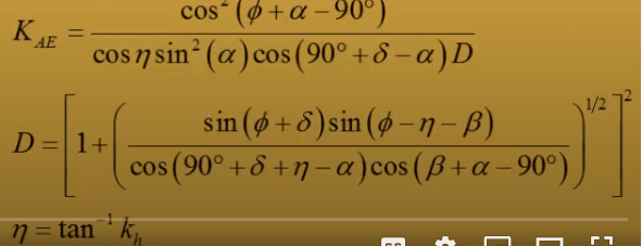

Kae is calculated based on soil friction angle, surface back slope angle, slope of back of wall, slope of failure wedge, interface friction angle etc.
What you have worked out from the above is your total seismic and static earth pressure. You can work all of these out for your wall. ΔKae is the seismic portion of earth pressure.
Your wall (if similar to the sketch you provided) is typical in terms of backslopes, friction angles etc. When you solve the above equation for Kae, and then work out ΔKae, you will see that ΔKae should be some where close ΔKae.
I would ignore the soil above the heel. Instead work out you seismic earth pressure (based on you soil failure wedge), and then seismic force and then apply it as if it acts on the back of the stem.
The structural guys need to help me here. When doing structural design of the wall, there are two seismic force that need to be considered. The lateral soil force (seismic and static) acting on the wall and the seismic force acting on the wall from its own inertia.
You need to consider the soil weight above the wedge as part of the seismic force acting on the wall from its own inertia. This is just mass (from soil and concrete weight) times kh.

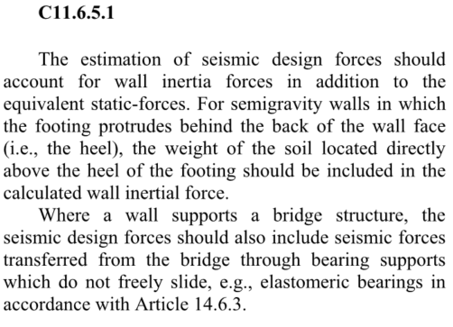

I mostly agree with EireChch, except for the very last part.
For the AASHTO method (most common, but different from the many other standards), the soil over the heel of a cantilever wall also has a pseudo-static lateral component. See 11.6.5.1 (8th Ed, 2017).
Not defending or promoting this approach over others, providing clarity re: AASHTO.
