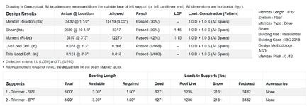

If you haven't already given it a shot, ForteWeb is pretty decent, one of the things that messes me up periodically is that the length of bearing has to be manually entered (unless I'm mistaken) so you can fiddle around with a heavily loaded header or a long header and see what happens between number of plies (bearing width), and bearing length.

To swing back to my ForteWeb comment, there's actually an option for the header bearing on a trimmer on the span page, but it's not checking the trimmer/jack studs for load, it's just making sure bearing is handled, as near as I can tell. If desperate the stud tables from Simpson can be looked at to eyeball a max load per trimmer/jack stud (Feel like there's an FAQ in the Wood forum for that one, by the by- There wasn't, so I created it now. Once the site starts showing where it is (the URL) I'll add the link and submit this post.

I typically use 2k and 3k capacity respectively for a 2x4 and 2x6 jack in a typical 9 ft. wall. This ends up being simultaneously roughly the capacity of the stud and header bearing. As such, I never check header bearing. I will check bearing in other situations though. One of many ways to save time in wood design.
Trimmer capacity of a 9' 2x4 is above 2k, so i get that, but the 2x6 is around 6k so I'm not really following that shortcut. If you're presuming a (2) 2x on a single stud the area (3" x 1.5") x 425 psi would be in the neighborhood. Thst sounds like it's more 3k for bearing than 3k for the stud trimmer capacity.
