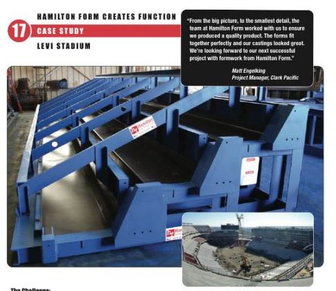

For industrial scale production, I've heard of fabricators using setups like this. I'm guessing that your thing is a bit more modest.
