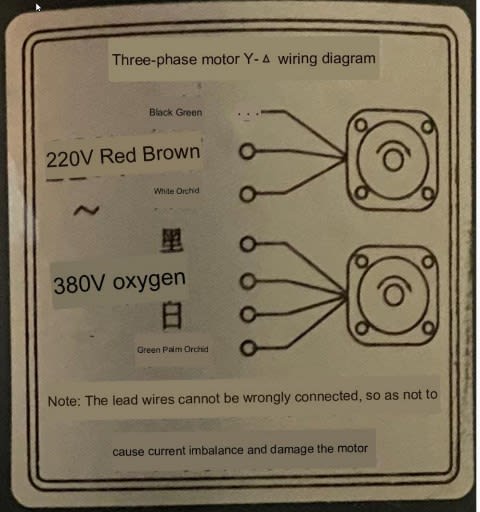

We have a Chinese motor with 6 leads coming out of it. It's a squirrel cage induction motor designed for three-phase power. Interestingly, the machine that this motor was found on is only taking L1 and L2, and N from the main board. This motor is intermittently lifting a heavy load up and down (like a 1-meter-tall elevator). The reversing of the motor is achieved by using an auxiliary contactor that reverses the L2 and N wires input to the motor. I wanted to understand how this is possible. There are no capacitors in this system. I have attached the photo of the sticker on the motor. For reference, we are running this in Europe with 220V 50HZ.
m.ahsaniftikhar,
Attach a nameplate photo and photo of connections in terminal box.
ACW
That's a garbage nameplate.
It's a dual 220 Delta/380 V Wye dual voltage motor.
If you have really six terminals, for 220 V Delta, you short terminals A1&B2, B1&C2 and C1&A2 for 3 ph 220 V input supply. For rotation reversal, you swap two supply terminals.

Something is strange with this wiring diagram.

@ Mr zlatkodo (Electrical)11 May 23 14:11
" Google is not omnipotent either.
Something is strange with this wiring diagram."
I am a Singaporean Chinese, NOT a machine. I am not omnipotent, but I understand what the drawing shows and try to explain as following:
1) it is a motor having 6 external connection leads, with colour (Black), (Red), (white); (Green), (Brown) and (Blue).
2) a)Power source 3-phase 220V, connect phase A to leads (Black)+(Green), phase B to (Red)+(Brown), and phase C to (White)+(Blue).
b) Power source 3-phase 380V, connect phase A to lead (Black), phase B to (Red), and phase C to (White).
Attention: leads (Green), (Brown) and (Blue) shall be individually terminated on individual terminal blocks, isolated from earth/ground.
3) With phase sequence ABC, leads connection as above 2) a) and b) ; motor operates in CW rotation.
4) In either voltages, only 3-phases (ABC)are used. Attention: Neutral is NOT used. Motor frame shall be earthed/grounded.
5) To reverse the rotation, "usually" interchange power source phase B and C.
Che Kuan Yau (Singapore)

Sounds like your installer used a neutral instead of a proper third phase. We call this "V phase" where I work. With the two legs 120 degrees from each other, you still have a rotating electrical field and some starting torque. The voltage and phase balance are all wrong for a three phase motor, but it's not exactly single phase either. Probably lucky that it lasted as long as it did.
