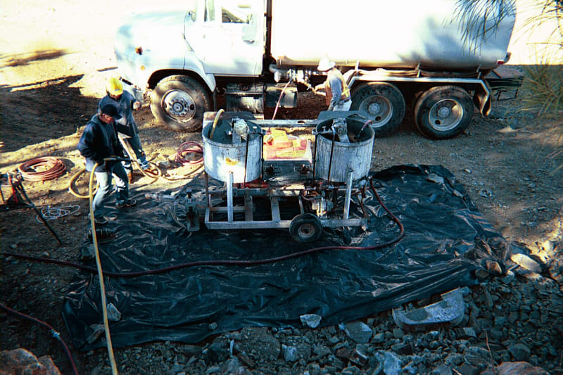

What type of companies have equipment to pump grout monitoring pressure and volume? Well drillers, or is there something else that I can search for in my area that might lead me to someone that can do this type of work?
probably not a driller, a specialty contractor. the equipment is not that sophisticated. volume monitoring simply means counting the number of bags of cement and gallons of water added

Anyone who does concrete pumping should be able to do grout pumping or knows a man who can.

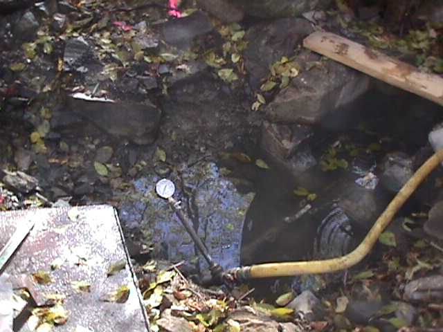

@CVG
We will try contracting some concrete pumpers and see what we come up with. Were those pictures you found on google, or personal photos?

my personal photos
I suggest to install a control valve at the down stream outlet, and you may conduct a pressure test after that to confirm the intactness of the pipe. Grout it only at the instruction of an expert. Good luck.
If you go to a cementing contractor ask them if they have heard of a Van Ruth Cementing & Wedging Plug. That will probably be required so that you can grout the pipe.
