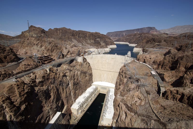

This was the last time I was at Hoover Dam/Lake Mead, eight years ago. I imagine that the lake level is much lower now than it was back then:
September 2013 (Sony A65)
This shot is from the first time we visited there. You can see that the level of the lake was much higher back in 1989:
December 1989 (Minolta XG-M)

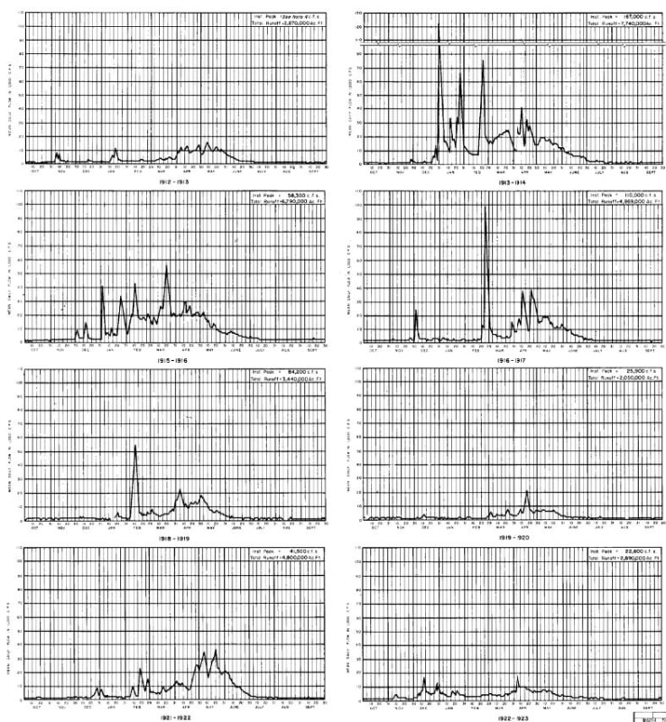

I am a structures guy, but have water records for a large watershed in Norcal from 1900 to 1960. What you see in those 60 years is what you see today: Extreme fluctuations in precip from year to year. Even before NASA engineers was warning about global cooling or global warming. While I cannot provide a good mathematical comparison between the previous period and the last 30 years, graphically the variation looks similar for the last 120 years.

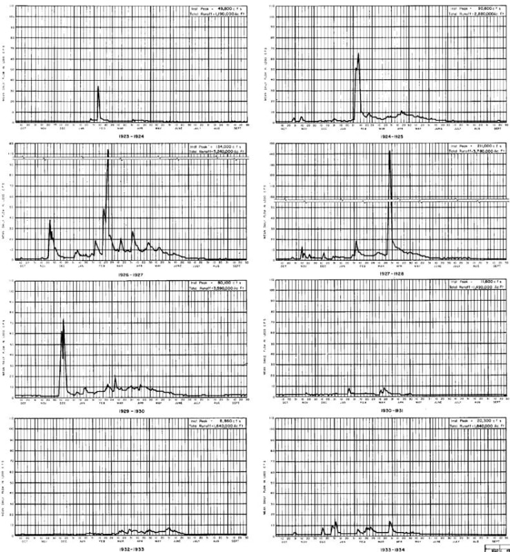

A few sample daily hydrographs from the 1920s and 1930s in Northern California. Attached and pasted below. You need young eyes to read the print, but you can seen extreme variation from year to year, not just in daily inflows but total precip in this particular watershed. Yes, I am being vague on purpose, but all of this is legit.
In fact, these should be public records thru Calif Natural Resources Agency, but in reality, it helps if you've worked as a consultant for the State, or know somebody on the inside.
Thank you.
It sure is all over the place.
Is there a correlation to El Niño?
