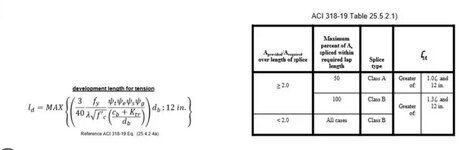

Speaking to tension laps in general terms, it goes like this:
1) Use code provisions like the one below to work out the development length of the bars as a function of their diameter (loosely reflecting bond stress).
2) Take your lap / splice length to be a multiple of the development length. 1.30 X or something like that depending on your code. This theoretically allows you to transfer the full yield stress of the bars being considered across the splice.
3) In some, but not all situations it maybe be permissible to prorate your splice tension capacity for a partially lapped bar configuration.
