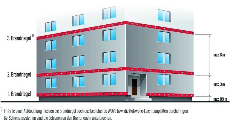

The building was from 2016 or so, with a insulated (XPS as far as I can tell from the reports) facade. Building codes in Germany mandate a fire barrier every two storeys - now there's speculation if this was actually implemented.

This is how the flame barriers should be positiones with an EPS insulation, barrier means >200mm strip of rockwool. To me (layman) 200mm does not seem like much.
The whole thing presumes that an insulation with (highly flammable) EPS is flame retardant, if built properly with a layer of plaster etc.
Yeah. 200mm doesn't exactly make me feel confident. It might work for horizontal panels.
