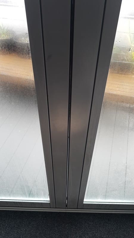

Just give them what they want, as someone who has a couple of bifold doors in my house don't skim on the deflection criteria as they do bind up a little otherwise and get harder to open over time if the deflection of the top and bottom frame is too much or vastly different.
Where they meet in my house at the middle for example there is a definite wider gap at the bottom than the top for example, and they run quite rough when opening them.
EDIT - FYI that opening is probably only 2400mm wide with two folding panels wither side.
Agent666
i wouldnt blame the header over your door. Knowing what i know about NZ alum windows, your bifolds are probably buckling under their own weight.
NZ residential construction is generally complete garbage compared to the rest of the developed world, and one of the poorest parts of NZ homes are the atrocious windows. look how badly those windows are sweating in your photo!
Most garden sheds in the US/Canada are built to a better standard than New Zealand single family homes.
