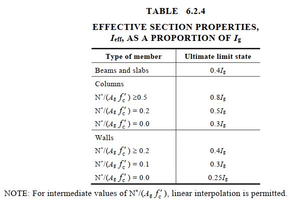

I've modelled a ten storey precast building in etabs and I'm using the shear wall designer to design the walls.
On the advice of senior collegaues I've split the shear walls to approximate the actual panel splits.
Set all in plane modifiers to 0.7. Ended up with a bit too much reo.
Said colleagues advised we can bring it down further to 0.4, reducing building stiffness and allowing the building to drift more, as long as within limits.
Reading on engtips some previous forums, I'm of the understanding that what I need to be doing is working out which walls are cracked, and assigning them a cracked modifier.
So I guess my first question is, is it safe to assume all shear walls are cracked like I have done? (Note I'm in Australia and the code stipulates N*/(Asf'c) ratios, see attached.)

thrice_a
 https://files.engineering.com/getfile.aspx?folder=50fa9ec7-8c2a-426e-9385-8aa3548959ec&file=As3600-6.2.4.JPG
Do not reduce stiffness to reduce rebar. If all walls are cracked, their relative stiffness and therefore, the loads they resist will be the same as what you have with a 0.7 modifier. Not quite sure on why reducing stiffness is changing wall rebar. Can you provide more detail?

I would agree with your colleague that 0.4 is a more realistic modifier for a cracked wall than 0.7. Refer to Table 6.2.4 of AS3600:2018. Clause 6.2.4.2 does say that for uncracked sections you should use use 1.0.
I don't know that particular code, but I don't consider rebar in the stiffness modifier and I don't use interpolation. I'd end up with successive iterative designs that keep changing the factor. You can use ETABS to check the shell stress and compare it to the modulus of rupture, and that's when you know if it's cracked. I don't remember the exact thing but I think it's F11 or S11 in ETABS. I'd say talk to your boss about establishing a stiffness modifier and use that. You can use cracked condition for lower floors and uncracked for upper floors, or use cracked for everything. 30% of lower floors cracked tends to work as a first guess.
One engineer I know uses 0.5 modifier for everything, regardless if it's cracked or not. He's been doing it for about 30 years, even before ETABS, so there must be some wisdom behind it. I don't take this approach but tend to crack the lower stories and uncrack the upper stories.
