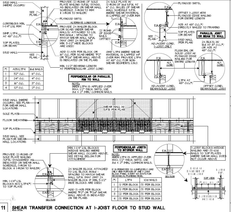

This is the First Detail for my typical raised footing. I dont have one yet for the addition of the cripple wall. But just picture that it the joists will bear ontop of the cripple wall that will then be anchored to the foundation in a similar manner.
For the Section on cripple wall image the stud wall is just a cripple wall here and the sheathing is continuous and cripple wall is on a sil with anchor bolts. The max height of the cripple wall is like 1'-3" above the footing shown in the detail above.
Okay based on your detail and my last post, I would feel comfortable saying the seismic mass of the floor does not make its way up to the roof.
But I would still design the floor as a diaphragm for Fpx. And I would strive to ignore the cripple walls for shear, consequently I would need to ensure there are enough E.N. and Sillplate anchor bolts over the concrete wall to transfer the Fpx level reaction force directly into the concrete. The other consequence is that your rim joist becomes a collector so you may need to amplify the load accordingly, and will want to ensure rim joist continuity or use tension ties.

You also have to decide if you want to take the shear from the walls above through this load path or if you want to continue the shear walls down the cripple wall area. This would greatly impact the level of force in the Rim.
So you would basically design the shear walls to support only the roof weight and half the wall weights when designing the sheathing and the hold downs, but you would use the floor and roof diagrams forces to design the anchorage and splice locations?

Really this one comes down to the details and the load path. If you have enough concrete stemwall and footing to resist all the loads generated at the lower floor and you can drag them back to it, then you could justify not including the mass in the vertical distribution. If that load path is in sufficient then look towards using the cripple walls as shearwalls and distribute the mass vertically with Cvx.
