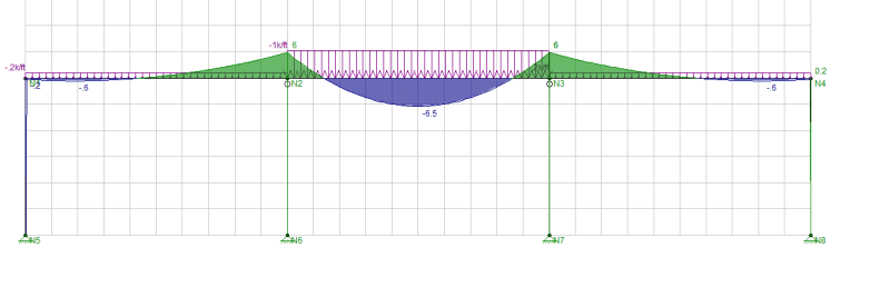

This is just speculation, the designer may be trying to reduced the braced length of the bottom flange for an unbalanced loading situation which would create larger lengths of negative moments in the adjacent members:

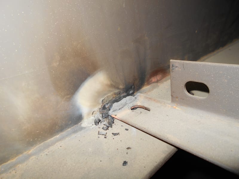

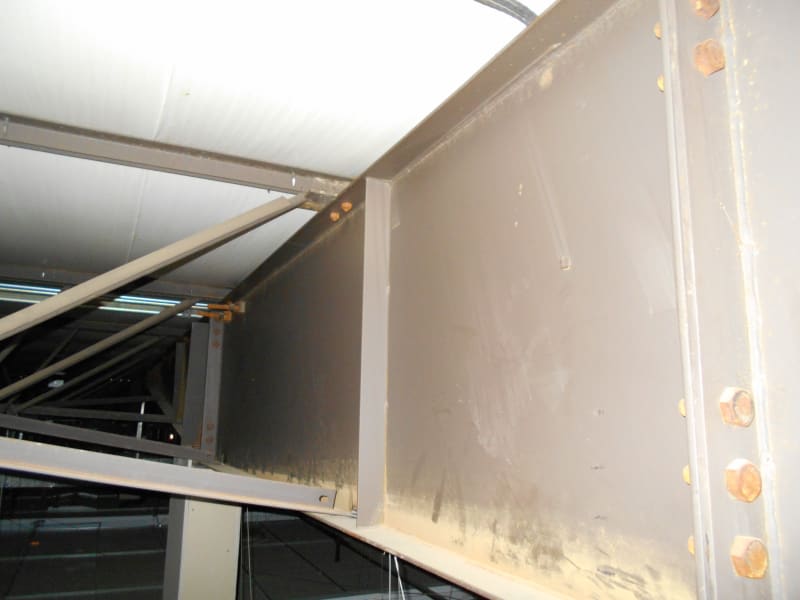

Even assuming that there are some X's or other termination anchorage theres not even any tabs/gussets at the beam fillet for a decent weld or bolt. Ive seen a handful of PEMB frames that skimp on bot flange bracing (L1.5x1.5 from purlin/joist to bot flange) and hit it with a one sided fillet weld right to the beam's fillet(weld since PEMB). Superb detail... OP's pic looks similarly frail.
Found the pics. See below. This particular specimen appears to be very tired.
