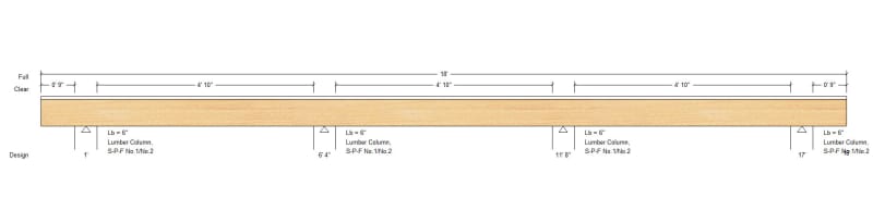

Have a situation where a deck floor (with roof) is supported by a 3 ply 2"x10" beam (floor and roof loads). The floor joists bear on the top of the beam and the bottom of the beam isn't laterally supported. The beam doesn't pass without lateral support on the bottom edge (tension). If there is lateral support at the midpoint of the beam then the beam passes. What is a good way to provide lateral support for the bottom of this beam?

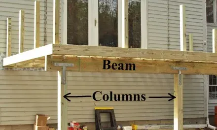

The first pic (taken from the web) just shows the basic idea of what the beam is and how it is loaded. The second image shows the actual beam with the sonotubes (the drawing shows the supports as 6" Lumber column but it will be sonotubes. Does this make more sense? [URL unfurl="true"]https://res.cloudinary.com/engineering-com/image/upload/v1705517108/tips/ledger-and-joists-annotated_acrtid.webp[/url]

To answer your original question, I would attach a kicker between the beam angled up to and lapped along the side of the nearest joist to the center of the beam. That should provide adequate bracing.
You could also put a kicker from the columns back up to the framing. Might be an easier detail.

The analysis seems to generally be reasonable, although here are a few comments:
[ol ]
[li]If the beam is exposed to moisture (which I'm guessing it might be if this is an exterior deck) and you plan on using pressure treated lumber, I would use Southern Pine No. 2 for the lumber species and grade, not SPF No.2.[/li]
[li]If this is an exterior deck, you should verify that the live load is correct. Our (US) codes typically require 60 psf for an exterior deck (1.5 times the LL of the occupancy served).[/li]
[li]The issue is clearly the low KL factor for negative bending. I would either add the bracing (kickers) or use a deeper beam. Although it will sound ridiculous, I wonder if the design would work if you modeled it as 3 separate beams (discontinuous at the 2 interior supports). Not saying you should do that, but it's at least interesting to think about.[/li]
[li]One other thing, if you could somewhere get a single piece beam as opposed to multi-ply, that would likely work better. I believe the Canadian code conservatively requires that the KL calculation be based on the geometry of a single ply rather than the fully assembled (4-ply) beam. [/li]

Thought I'd just follow up with what we will be going with. We used the same spans as shown in the pic above. But, we used a 3 ply 2"x10" set at wet service and pressure treated SPF#2 (Southern Pine isn't readily available here in eastern Canada). The contractor wanted a continuous beam, wasn't interested in simple spans. Lateral support on the top of the beam was set at 16"OC, and on the bottom laterally supported at the supports.
That setup was passed by Woodworks.
