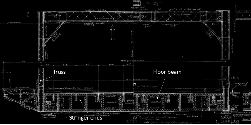

Good day all.
I am analyzing a bascule bridge span constructed in 1929. As shown in the floor plan, the vertical lines indicate floor beams (4-feet deep). The horizontal lines are stringers (20- inch deep). Stringers are riveted to the floor beam as shown in the photo.
To reduce the weight of the bascule span, steel grating is used instead of a concrete deck. That means, the top flange of the floor beam is not continuously restrained against LTB. My question is:
1. Are those stringers able to provide lateral restraint to the floor beam at their connection points?
2. Stating otherwise, in performing Moment Capacity with LTB calculation, should the unsupported length be taken as L (full length of the floor beam) ? Or should it be S (the stringer spacing)? Thank you.

@ gusmurr, thank you for your reply.
@ BridgeSmith
Actually, this bridge does not have girders. It's a lift bridge with trusses at two longitudinal ends.
I understand that the photo can be confusing. You are thinking that the top gray members are stringers (but they are small beams carrying the steel grating). Stringers and floor beams are exactly as I labeled in the photo. These large transverse floor beams rest on longitudinal truss bottom chords - which are not visible in the photo. May be that is the reason of confusion.
Anyway, I looked online for the 2% restraint. I did not find any North American source, but the British take 2.5%, and that's a small load indeed. So I concluded that the large transverse floor beams are adequately restrained by the stringers through the riveted angle connection shown in the photo.
Here is is a cross section showing floor beam and truss. The stringers are perpendicular to the screen so only their ends are visible.
Hope this dispels any confusion.
I was indeed misunderstanding the configuration. My apologies for not paying closer attention to the labeling in the photo.
I would say it's very clear that the floor beams are braced against LTB by the stringers. Even if the stringers are not restrained from longitudinal movement, I'm confident you could easily prove there's adequate moment restraint in the riveted connection and the stringers to produce stability against global LTB failure.
Intermediate restraint of the stringers themselves (by the grating beams) would be questionable, but as long as their unbraced length from floor beam to floor beam is not long enough for them to be subject to LTB, then you're ok there, too.
Thank you BridgeSmith.
Stringers are 6.35 m long (20' - 10") from FB to FB. But each stringer carries as many as 12 grating beams on top; grating beams are welded to stringers. So based on your earlier comments, I believe the stringer themselves are also laterally restrained.
As long as the welds stay intact, you should be able to assume the compression flanges of the stringers are braced. We've found connections like that to be susceptible to weld breakage, and it's been a subject of much debate as to whether the flanges can be considered braced if the welds are broken.
