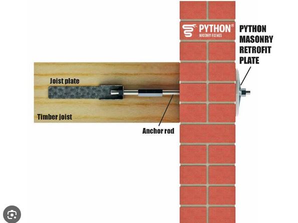

What JAE suggested is not straps but rather anchor rods tying into the structure itself, which will be restrained by the diaphragm.

I'm not sure how you would anchor it into the framing without using some type of strapping? You're saying anchor rods through the masonry into the framing? They would have to be some very long anchor rods...
Yes - long anchor rods with threaded ends. Usually some type of exterior "washer" plate is used to lay flat on the exterior brick. The rod is extended through a hole drilled through the brick chimney (yes a long drill bit) and extended into the floor structure. The floor / roof joists may be perpendicular or parallel to the rod so you'd have to verify that and detail a connection of some kind betwween the rod and the wood framing. Usually some type of additional blocking and perhaps a small 3x3 clip angle for the bolt to fasten to.
I would be hesitant to try to crank on the rod nut in an attempt to pull it back level. This is only a method to stabilize the overall chimney and mitigate further movement away from the house.
With the rods installed, further settlement of the foundation would probably cause exterior cracking to increase on the brick face (rods pulling back, settlement bending the chimney) so the whole assembly should be monitored on a regular basis for the next couple of years to ensure things are still stable.
Underpinning with piling would be a second step to help minimize settlements and the resulting cracking. Even with helicals I would recommend monitoring.

I'll counter milkshakelake - it's usually a combination of straps and bolts. For retrofits, it's usually a steel strap that goes around the outside of the chimney and then gets bolted to a tension tie either fastened to the joists or to blocking between joists that gets nailed to the diaphragm.
These are pretty standard details in seismic country where the vastly different response of a masonry chimney and light frame wood house would have them slamming into one another irreparably at the slightest ground movement. (See IRC R1003.4 Seismic anchorage.)
The only issue I see with a strap is how it'll be tightened enough to restrain the chimney. If it's used like a belt around the chimney, it's flexible enough that the corners could pull out. A bunch of bolts around the chimney should mitigate that because at least it'll be in tension between the bolts. If this is the solution paired with what JAE suggested, I imagine any generic 3" or 4" 18 gage or 20 gage Fy=36 ksi strap should work. They can take crazy amounts of tension for how thin they are, like 2 kips or more. I wouldn't go to 2" straps just because of edge distance and tolerance issues.

I agree, JAE's solution is cleaner and looks better...but it may be tough to set those effectively depending on the size of the chimney. I've seen it used on large chimneys with several wythes of brick to get into...but a lot of single wythe residential chimneys just don't have the 'meat' to get it in and not risk damage to the flue.
Yes, the 'belt' is tacky and prying at the connection is an issue...but one that can be accounted for. They're usually cheaper (a lot less labor) and, if painted the same color as the brick, often go unnoticed by the casual passerby.
