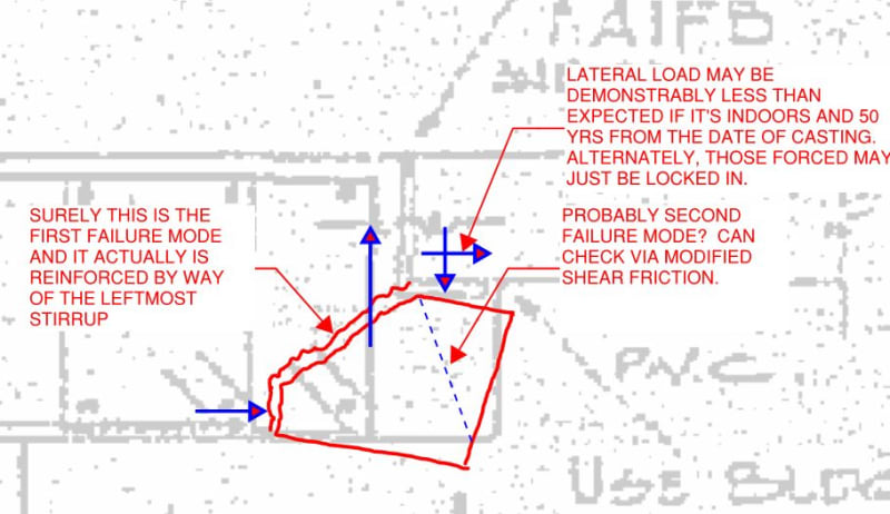

I'm also on team reinforce/replace. That said, see below for a little devilish advocation. Something that I've learned about ledges in my travels is that they are relatively insensitive to the amount of flexural reinforcing provided. Failure initiates by way of a straight shear rupture. A failure mode which, I would argue, actually is reinforced.

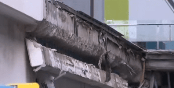

Scroll down this recent thread for a good visual of a “failed nib”: thread815-454584
From the post that Bones mentioned. It appears to be a rather shallow nib where the shear failure plane somehow ducked under the stirrups without engaging them.
