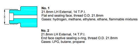

Like dtimberlake mentioned; fuel gas fittings often have LH threads; like most cylinder valves meant for flammable mixtures. But I have also seen a M19x1.5 LH thread on a nitrous oxide cylinder at an offshore facility once; wheras the rest of the industry uses RH threads...
Regarding dtimberlake's comment #14 above, the use of LH and RH threads in gas fittings is for an entirely different purpose. When I was learning oxy-acetylene welding, it was explained to me that (after both gas cylinders had been attached to the welding torch) you turned on the oxygen first, ignited it, then gradually turned on the acetylene. If you reversed the attachment of the bottles you would light the acetylene first. This was a mistake that NOBODY could make twice.
LH threads are also a great way to make Joe the Homeowner think twice before using the equipment.
Oxygen is not flammable; just an oxidizer. Cutting torches are supposed to be ignited using pure acetylen; possibly with a very small amount of oxygen to avoid bothersome soot. You then adjust the flame characteristic to whatever purpose using the preheated oxygen valve. In cases of persistent blowbacks howevever you would ALWAYS close the oxygen valves first.
