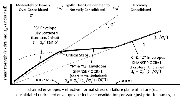

I believe that we should be using the
fattdad said:
Can't use cohesion!
design line forced through zero on the "S" envelope.
I also believe in slope stability analysis today there is a common belief the triaxial compression test results are what should be used without the consideration for DSS or TE results.
