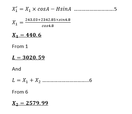

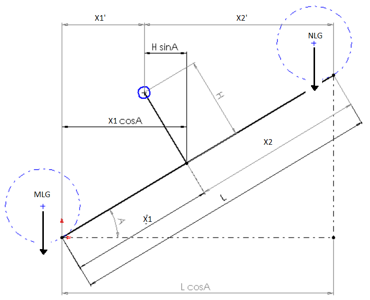

Now taking all the advice into consideration this is what I've come up with, It feels that we are almost there, so close but yet so far. [rednose]
It seems that there should be a way to use a ratio, of some sort, of the A/C in the known tilted attitude to "predict" the Zero degree attitude weight distribution of each wheel? Please advice and comment if I'm on the right track or completely missing the point.
I'm using the picture below as a guidance for illustrating the thinking process. It is Based on Situation A as illustrated in the top of this discussion.
Now
And that where I'm stuck.
Please feel free to Comment and give some further awesome guidance.

I'd draw the ground reactions normal to the ground and on the ground, and the a/c CG is the only point off the ground and the weight is vertical (ie where it intercepts the ground plane is affected by the inclination).

I think sum(ground reactions) = Wt*cos(theta) ...
you say (original post) "3131 KG on the Main LG" ... as the sum of both MLG scales ?
at 4.8deg total wt is 3406kg ? so a/c wt is 3418kg
at 2 deg 3398kg ... well, there's your problem (with this method at least) ... a lower angle should have a higher sum reactions.

In A A/C WT= 3406/Cos(4.8)=3418
and in B (If I assume that the ground reactions should have been the same in A and B, then
A/C WT=3406/cos(2)=3408KG so what is actually wrong then? Am I missing what you're saying?
Kind Regards
E
no, the actual reactions should be different for different inclinations, but the sum should be Wt*cos(theta)
4.8deg sum reactions is 3406 ... a/c wt = 3406/cos(4.8) = 3418 kg
2 deg sum reactions is 3398 ... a/c wt is 3398/cos(2) = 3400 kg
if we add experimeter error into the mix then the difference between the two is negligible (within experimeter noise)

I guess you could use the two experiments separately and calculate the CG position for both and see how different they are ?

rb1957 to get back to your comment, I do understand that the reaction should be higher as the angle get smaller.
If I understand you correctly I can use the "3406/cos(4.8) = 3418 kg" and with a ratio work back to what each LG position weigh?

yes, you have two weighing "experiments". You can calc a CG position from both.
it seems "odd" that you are so sure of the CG height
