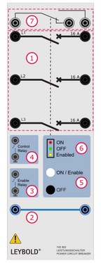

Hi all
please could you provide more informations about the coordination of this relaly with the power circuit breaker

Sure, I'll add some information for examples, the protected load is a variable resistive load.
I'll add the other experimental blocks to clarify more.
This is practically the main association of the rest of the experimental blocks.

I want to protect the load from over-voltage and under-voltage when the resistive load changes. I mean, after gradually changing the load, we observe the load voltage and check the relay's behavior in response to these changes.

on the transformer secondary
If you are using this to trip the breaker:
But the relay here send an information to the breaker to open the circuit,
What do do you mean by ''bypass it'' ??
