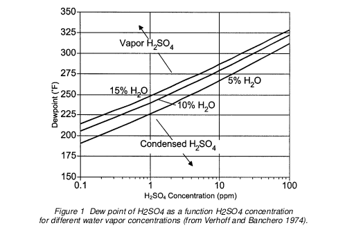

Most power plants boilers attempt to exhaust stack gas a bit above the condensation temperature. Lower than this and significant additional cost is incurred as corrosion resistant material.
For coal and 2.5% sulfur heavy oil, and no emissions scrubbing this works out to about 450F to 550F. For natural gas and low sulfur oil perhaps 250F.
[URL unfurl="true" said:
https://www.babcockpower.com/wp-content/uploads/2018/02/emissions-of-sulfur-trioxide-from-coal-fired-power-plants.pdf[/URL]]
I could see 1100C for a peaking power plant, but you would not want to run that all the time, as the cost of fuel vs a combined cycle plant.
