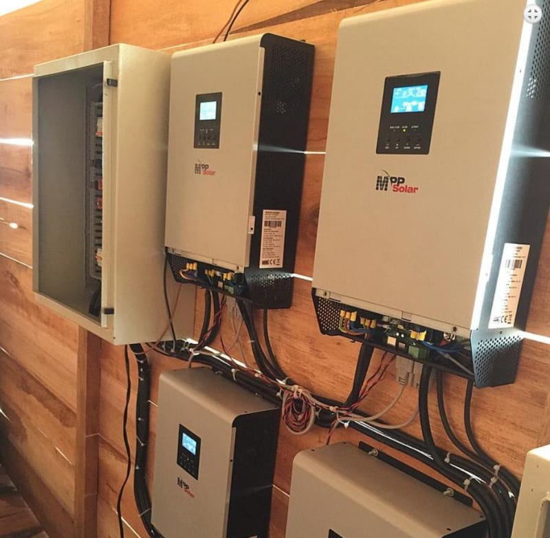

Here's a typical 'all-in-one' type inverter solar charger: MPP-PIP-LV5048
That's 5kW and you can gang fistfuls of them together (something like 6). They'll provide 120V,208,and 3 phase as desired.
You can also use them without solar. You can use them and some amount of battery and the they will take in crummy utility power, dump it on the batteries and invert out clean sinewave power continuing to run uninterrupted if the utility drops entirely. For further backup support you can run an inverter generator into them if the utility goes dark and what your loads don't use will be stuffed in the battery bank.

Hi Keith, have you used those inverters? They're really attractively priced.
I am using one of them, the LV2424, and will be getting another shortly. I will be using them ganged to get me 120/240 split phase power as currently with one I only have 120V. I will be using them to get me thru our crummy local power company's so called 'Safety Power Outages'. I have about 40kWhrs worth of batteries. Some new some used. I'm slowly adding solar panels.
This is 'sort of' what I'm talking about: Hand Truck Solar System: 2.4kWh LiFePO4, 2.4kW Inverter, ATS, 1.4kW AC Charger, 1.8kW PV Input
I'm doing this except I'm using two of those inverter/chargers, three times that much battery, and I've rolled my own battery management system (BMS) using a PLC.

Those MPP inverters are not what I'd call 'bomb proof' but one very nice aspect is if you have problem or fry a board the company will actually mail you replacement boards. (The benefits of no stupid lawyers.)

Those particular all-in-ones have a UPS mode which has trigger points like;
Low Loss Voltage = 95Vac
Low Loss Return Voltage = 100Vac
High Loss Voltage = 140Vac
High Loss Return Voltage = 135Vac
Maximum Voltage = 150Vac
42 to 63Hz without alarming.
It also states; "Output power derating:
When AC input voltage drops to 95V, the
output power will be derated."
And, the derating chart continues down to 65Vac input.
So I 'think' they'd be okay with his conditions. As soon as something excessive happens the inverter disconnects from the mains and continues running the loads on battery.
It might still make sense to include a line reactor in front of them as a moderator if things are really nasty.
