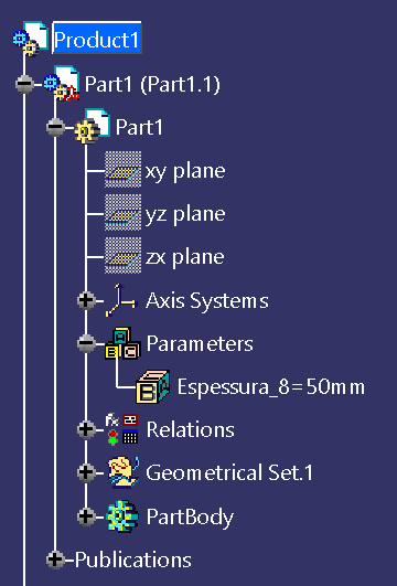

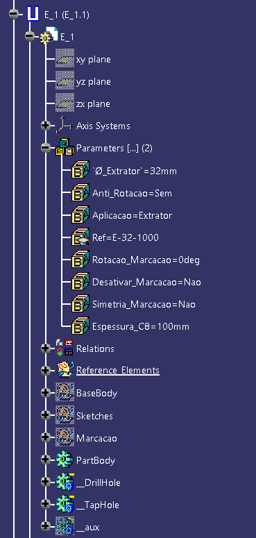

In this picture i have the component i insert, and it has some parameters, i want to get the parameter "Espessura_C8"
Then in this picture i have the parameter "Espessura_8"
I want to create a new raltions set on the product or inside the component (preferably on the product) and relate the parameter "Espessura_C8" with the parameter "Espessura_8", witrh a formula.

I your parameters are located in different parts then you can't create a relation between them programmatically.
Relation within a part must include local parameters only that's why when you create a formula manually "External parameters" set gets created.
This can be replicated by copying sorc paramet to your part with Selection.Copy and then creating formula referring that copy.
Hi Little Cthullu, i actually could do want i wanted but its missing some things.
Code:
Option Explicit
Sub main()
Dim productDocument1 As productDocument
Set productDocument1 = CATIA.ActiveDocument
Dim product1 As product
Set product1 = productDocument1.product
Set product1 = product1.ReferenceProduct
Dim relations1 As relations
Set relations1 = product1.relations
Dim documents1 As Documents
Set documents1 = CATIA.Documents
Dim par As partDocument
Set par = documents1.Item("E_1.CATPart")
Dim p As Parameter
Set p = par.Part.Parameters.GetItem("Espessura_C8")
Dim relations2 As relations
Set relations2 = par.Part.relations
Dim formula1 As Formula
Set formula1 = relations1.CreateFormula("", "", p, "Part1\Espessura_8 ")
End Sub]
Now i want when i click to run the macro to let me choose what product i want, and then search inside that product all the components that have the paramenter name "Espessura_C8" and if it has create the relation.
