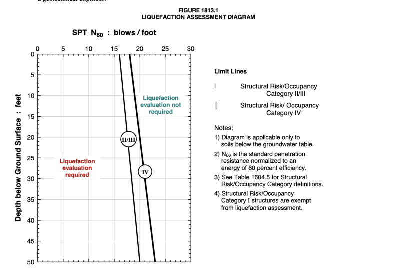

If there was a boring with N-values (refer to Standard Penetration Test), then you'd have data to provide. If you don't have these data, then there'd be no real basis, but fear, to consider the risk of liquefaction.
There is some code-referenced design acceleration, I'd suspect. If you know that value, then the N-values can inform to what extent the risk is real. Seed and Idris have nomographs to address this topic. Most geotechnical engineers know about Seed and Idriss nomographs. Not all states may allow such simplification; however.

We do have borings. N-value varies from 12 @ 15 ft, 8 @ 20 ft, 13 @ 25 ft, 14 @ 30 ft & 13 @ 35 ft. This is 140lb Hammer with 30" drop.
Did the geotech run the liquefaction analysis? They should be able to tell you how much settlement to anticipate and you can pass that info onto the owner. If it’s a small amount maybe you can get away shallow foundations with the owner accepting the risk of settlement and distress.

The geotech did the liquefaction analysis. I am going by the recommendations made in their report.
Sounds like your hands are tied. Did they say how much liquefaction settlement is anticipated?
