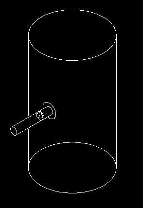

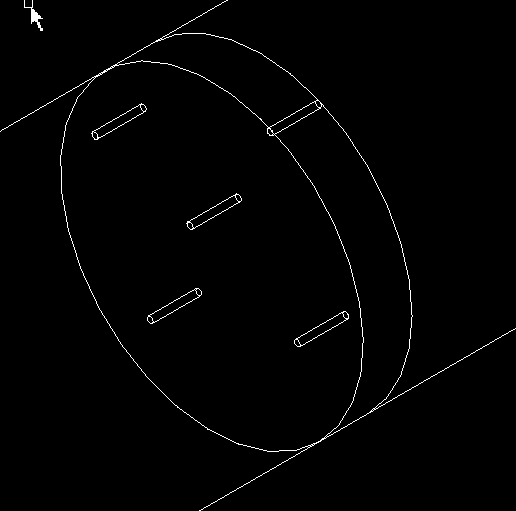

Is your application something similar to the attached images? Edit: For reference, the thickness ratio of hole diameter to plate thickness on the orifice on that sketch is 8x.
Similar - though my plate is flush with the top of the vessel. And I have a lot more holes in the plate!
How many hole diameters is the spacing between holes?
