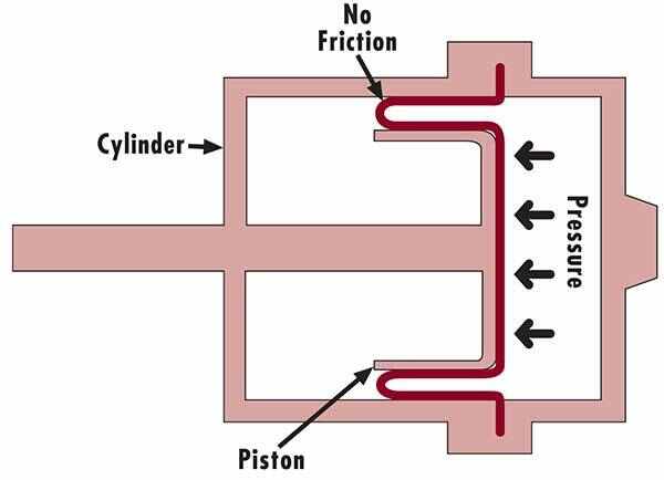

Another option you might consider is a rolling diaphragm cylinder. They generally are actuated by air, but liquid can be used if pressure is not high. Most are single acting, so they rely on a spring or gravity for the return stroke. Some manufacturers offer a double-acting design.
They do not have any dynamic seals because the fluid is enclosed within a rolling diaphragm.
I suggest going to controlair(dot)com to see examples.
We do a lot of rolling diaphragms in my company. Seal friction per se may be negligible, but the seal convolution still has loss properties (bending of the rubber diaphragm wall) that must be overcome to drive the piston.
Sister company does a lot of bellows. Bellows have to have a stiff enough wall to not expand under the applied pressure differential and blow out the convolutions. If the wall is stiff enough, then the bellows have a spring constant that will affect the force required for a given displacement, i.e. the force will increase/decrease with stroke distance.
