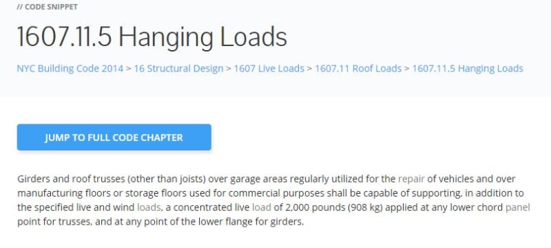

Agree with above, you have to use engineering judgement. Here is another data point. 2,000 lb for lower chord of commercial garages.

GC_Hopi, that load of 2000# sounds as though it's for lifting things, eg engine.
