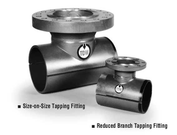

A full size tee (8" x 8") isn't that common though and I wasn't sure if it is actually feasible. - "The City is going to perform a live 8" x 8" tapping sleeve "
This implies the cutter is taking away 50% of the existing pipe.
An 8" x 6" I thought was the biggest you can do.
LittleInch is right. You can't do an 8" tap on an 8" line. What I've done in the past is do a 6" tap and then use a reducer to go from 6" to 8". There's some additional head loss through the reducer, so it needs to be analyzed and the pipe may need to be upsized to provide proper pressure at the required flow. Since 8" is usually the minimum required for fire water, I've always had sufficient capacity even with the restriction.

I do not think I would so a hot tap this way, but "Split T" tapping saddles are on the market that are designed for full size taps. These are installed by welding then together, and then they are welded to the carrier pipe.
Source T. D. Williamson Inc, TDW Tapping Fittings catalog.
You could verify fitting was designed for the installation arrangement and has an appropriate pressure rating. Reviewing the OEM guidance is worthwhile.
