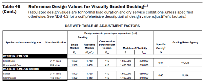

The only section I'm aware of in the NDS that contains mechanical properties for a species labeled "Western Hemlock" is table 4E of the supplement, which is visually graded decking, which is not material I would normally expect to go into wood trusses.
