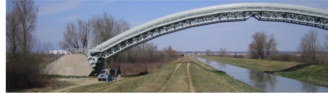

Hello,
I was hired by a water supplier company to design a arched truss that will support a water pipe over a river. The truss will span 50 meters.
For the design lodas, i'm considering the pipe, water and structure weights, Wind and hydraulic thrust, but some maintenance workers will eventually go over the structure. The company didn't provide this additional load and i cannot found anything similar in the brazilian codes.
Does anyone knows a code provision of some country for a structure like this?
Thank you.
 https://files.engineering.com/getfile.aspx?folder=04fe17af-8f14-4e77-86c0-4cb2b2d8dd7d&file=Screenshot_20220810-115245_Drive.jpg
PS: The drawing was given by the company only for illustrative purposes.
Don't think you'll find this in any "code" as it is a restricted access bridge in effect.
Just assume 4 100kg blokes at the centre point as a live load and add some signs on the structure saying no more than xx persons allowed on the structure at any one time. Can't think it's going to make any real impact though as the lateral wind loads are probably your defining load.
They are nice pipe bridges though.

This is one over a canal somewhere.

The schematic drawing is not depicting a box truss, but rather a U-shaped structure. Be careful about the buckling of such a structure. I would make it a box and add separate, non-structural guardrail for the walkway. (And use 40 psf LL on the walkway).

HUGE concrete blocks at each end though

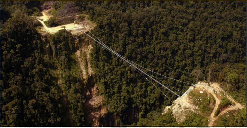

A cable suspended pipe would be a very economical solution, and it handles wind forces easily.
