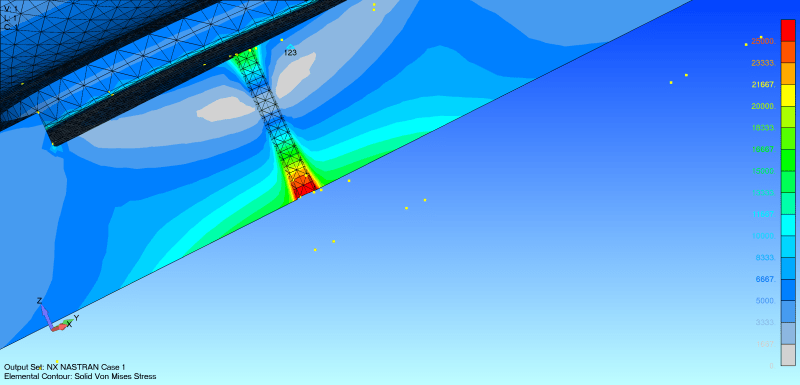

When meshing the below part I meshed the entire part to 0.5" using Mesh--> Geometry --> Solids. Then after the first iteration I noticed a large stress gradient near a small hole in the middle of the part, so instead of refining the mesh globally using the same command before I went to the meshing toolbar and refined the mesh by surface right around the stress gradient. This took two additional iterations before I got the mesh to converge. On the surface everything looks great; however, when refining a solid mesh by surface I have no idea what is going on through the cross section of the part. What's to say that the mesh is converged for any of the elements not on the immediate surface if that makes any sense.
Almost forgot the image. Also I realize I absolutely killed this piece with tiny TET elements, but my stress concentration was much smaller than the overall piece. I suppose that's a topic for a whole different conversation.

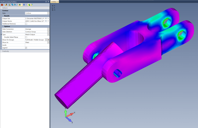

If you are concerned about the cross section you can use the Section Cut to view the contours of elements within the solid. If you see any peak stress in an area that isn't around a feature check to element quality in that area. If the quality is bad it might be an artificial peak.
Normal:
Section Cut:
Ah, great trick TG. I was using the section cut in the view settings, which doesn't show solids through the section. Too bad the contour doesn't show filled edges in the middle, but at least it shows if there is a smooth stress gradient.
Karachun, I did think about doing that for this part, but I could see that being tedious to cut out and glue stress concentration regions in every model. By your suggestion to slice the region and "globally" remesh the slice are you saying you agree that it is a problem to refine the mesh by surface?
If you use tet mesh then yes, you can refine mesh on curve/surface. My motto is "hexa mesh or nothing", I use structured hexa mesh where it is possible, because hexa mesh is accurate, light and neat.

You can reduce number of contact pairs to one or two. On picture below, nonconformal mesh presented only near small hole location.
That is definitely a beautiful mesh and I too prefer to use a HEX mesh wherever possible. I’ve always been a little hesitant to overuse glued connections, because I don’t understand how it isn’t adding stiffness to the stiffness matrix. From my best understanding of glued connections what FEMAP is doing to glue surfaces is connecting nodes at glued surfaces with rigid connectors I.e. perfectly transferring translations and moments from node to node.
The rest of my part not shown here has some nasty geometry that would take days to prepare for a hex mesh, so I would embed the surface around the stress concentration shown and HEX mesh it, but undoubtedly there’s not going to be a great match between the nodes on the HEX meshed surface and the TET meshed surface. How big of a concern is that? It seems to me that the farther these rigid elements have to “reach” from node to node the more inaccurate the displacement results become.
All this to say it would be far easier to be able to TET mesh this part and refine locally near stress gradients, which FEMAP obviously offers the capability to do, but I just don’t have a good idea of what is going on under the surface and want to figure out if I should be concerned about using this work flow.
