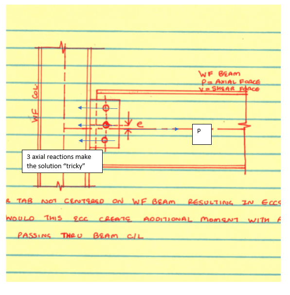

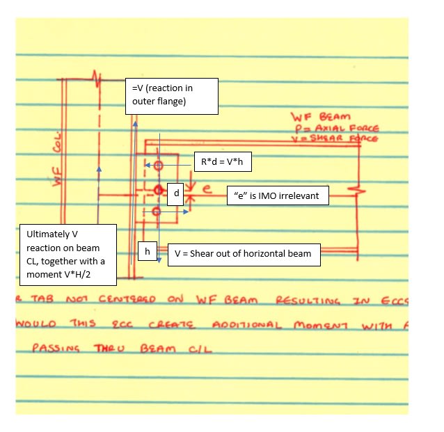

I am designing a connection under combined shear and axial loading on a WF beam framing to WF column. If the center of connection material (shear tab or double angle) needs to be placed vertically offset from the centerline of the WF beam due to some constraints, is there an additional eccentricity that needs to be considered for connection design? Could someone please provide any guidance or refer to an existing post?
