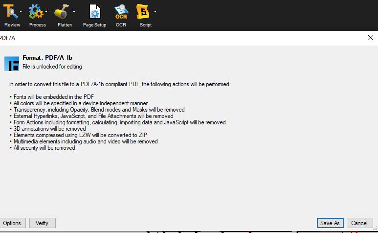

I am not sure about the rules in the US, but you can save .pdf as a type b for some added security. That is under the process tab in bluebeam.

Yes there's a difference between scanning a stamp and pasting it into a pdf then flattening it. To have a verified/e-signed/authenticated tamper proof pdf, you must use the "Sign Document" or "Certify Document" tool in Bluebeam: Tools>Signature. You must also have a digital identity. I'm not too familiar with that as i've never had to personally authenticate that, but i've dealt with the certified documents. It can be rather finnicky.
You can create a signature in bluebeam (or acrobat) to digitally sign a PDF - however when you do this, it is self verified/authenticated. Most states that require a digital signature (not the same thing as a scanned image that has been flattened), require it to be 3rd party verified/authenticated. This means you need to purchase your authenticated signature from a company that provides this service. I use Identrust. When you do this, first they verify your identity, then they provide you access to the signature (I went with the USB token route), so whenever I sign a document I have to have the usb token plugged into my computer and I have to insert a password. When signing you can pick what restrictions are placed on the document (printing, editing, redlining, etc.). When you open a signed document it will tell you it is signed and depending on your settings, restrict any type of editing, or allow to edit, but break the signature. For instance, if the field redlines it and saves a copy, when you open it it will state that it was previously signed but has been changed and is no longer a valid signature.
Also, once signed you can look at the properties of the signature - one of the properties is the signers certificate which tells you who issued (verified) the signature. This is where the 3rd party requirement can be checked by anyone viewing the document.
