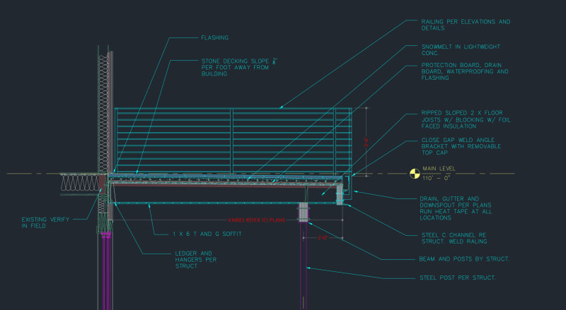

Here is the detail per architect. The beam will probably be steel. There is an existing drip through deck. It will now be waterproof with concrete topping.
I have to say, I have not seen many concrete-over-wood decks (a few but not many), and even fewer concrete over wood supported by steel. I am not sure what your joist spans are or exactly the dead load of the proposed system, but hanging that much dead load off a ledger may be difficult to make work. Existing framing below should be checked for the new dead load. I think I would be very tempted to make this a "free standing" deck if possible.
Regarding the steel beam, I agree with the comments above. Continuous or simple span will not make a huge difference as long as it is detailed accordingly and constructability is considered based on the size of the overall job.
My default would be 4 simply supported beams with shear tab connections to the columns. It’s simple and easy to install. If I understand correctly that the beams only span 12.5 ft, it should be easy to choose a size which has negligible deflection and end rotation.
Yea, hopefully you have a better connection to the house than is what is shown.
The new ledger will be lower and wont line up with rim. So I have to put flat 2x member between studs to accept however many ledgerloks screws (or anything similar). The 2x members will be attached to studs either side with simpson angles, or maybe ill install studs below the flat 2x both sides. That’s my plan, let me know what you think.
Like RPGs pointed out, aesthetic is my #1 priority. I have never seen decks in this area with steel beams hanging from the side of columns. They usually go above the columns. I am thinking about maybe just size the beam for simple supported and just connect the web about 6” from the column (no moment transfer). I feel like connecting it at the inflection point doesn’t look very pretty? Better to be closer to the post?
Doublestud, refer to AISC manual Part 10 for beam-to-column, standard single plate shear connections.
Frankly, I don't see the need for steel beam(s) if all the other framing is conventional wood deck framing. Also, like RWW0002 said, the combination of the various materials shown in the drawing is something I also have not seen often/ever. I would not be keen to combine concrete and wood. That said, the steel beam(s) portion looks pretty straight forward.
