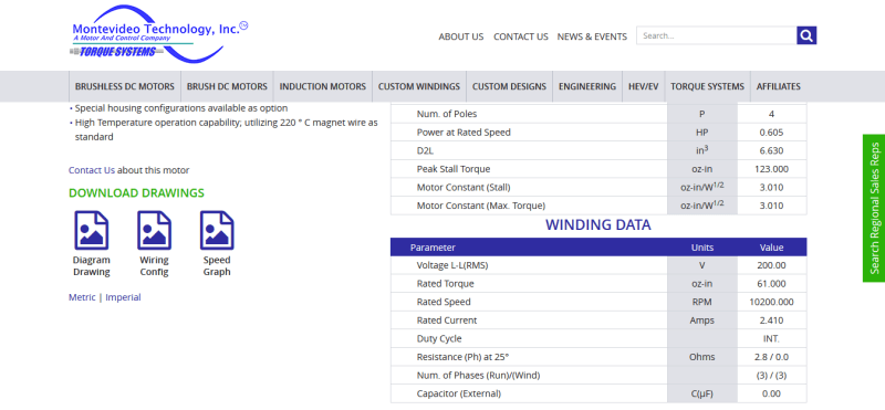

Looking for a suitable motor to replace the fan motor in a hydraulic oil cooler. The motor specified by the OEM is becoming scarce and/or prohibitively expensive. The motors are found on a ~40 year old aircraft that is going out of production soon. I expect more problems in the supply chain like this will be coming.
The fan is enclosed in a duct, so any growth of the motor diameter restricts the flow in the duct. The ideal motor would be found from off-the-shelf motors in production, rather than custom ordered. But we will consider a custom order if it doesn't need much NRE, and actually may ask for a unique part number for our use only. Quantities will be very low <10 units.
Specs:
Must operate on 3-phase 200 VAC at 400 Hz at least 10,000 RPM with at least 3.5 lb-in torque load.
My requirement is only about 0.6 HP continuous.
The current motor’s envelope is 2.5” OD X 4.0” long.
The shaft is 1.2” long x 0.312” diameter, with 2 set-screw flats.
The motor's case is completely sealed. No internal fan.
Rotation is counter-clockwise looking at the shaft end.
Needs an internal temperature protection switch with external wires to allow external fault detection.
I expect the air flowing through the oil cooler is normally <100 deg C, but may be much higher at times.
Wires coming out the side are easiest to deal with. Wires coming out the back end are next choice.
Wired in Star, with the Neutral on a 4th external wire. With the temp switch, total 6 wires needed.
Hopefully you can identify something that’s close to this.
We have tried Reuland Electric - too small for their product lines, so they would have to start from scratch.
I have been in touch with Montevideo Tech. They have a nearly perfect motor, but it is discontinued, and now they're pushing us toward a custom unit. I don't know if I can steer them back to my preferred path (make more of the old motor design, please). And they're struggling with some other communication-related things that should not be problems in the year 2020.
I am still running the phone-tag-e-mail obstacle course with the motor's OEM and their distributors. There may be hope that we were just misquoted, or they can supply an alternative themselves.
