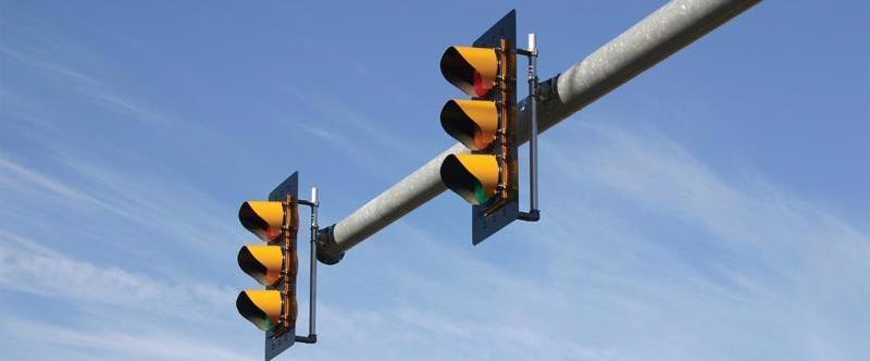

I'm working on a project that would benefit from cheap tubing as a frame. However, I'm not too familiar with some of the methods of fixing them together.
I attached a basic view of the structure. Yes, made in paint, but it gets the point across I think.
Some examples of how I imagine it fitting together would use something like a clamp that fits around the tube and tightens with a couple bolts:
My problem is that I'm not too familiar with this market/engineering.
Are there any standards that I should know/would be helpful to know?
And most importantly, are there equations for these fittings for how much they can hold.
As you (might) be able to see, a lot of the force is down, and runs along the length of one of the pipes. I'm concerned that this wouldn't support much weight.
I would like to see if they can hold up about 10 lbs and a bit of occasional vibration.
I might be dumb and am going in the wrong direction. Maybe there is some better material for this.
Edit: here is a better example

Under normal circumstances it should just sit there. A very rare shock load is estimated at 800 lb-in in torque. I noticed structures like these, they seemed to hold up nicely:
@MJCronin, that image is all I can give, and is frankly even unnecessary. I'm just looking for conceptual stuff; I'll take it from there.
And this is a safety issue. Drop one of those fixtures on a moving car and you can easily kill someone. I believe there are standards associated with these, anything you build must comply with the standards. What country are you building this in?

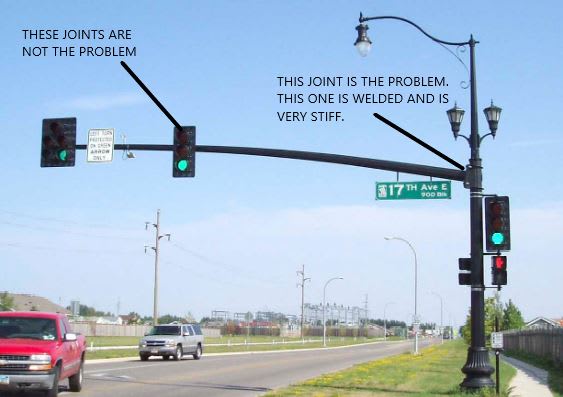

Ordinarily one would have dimensions and how the structure is attached to the world and some idea of how the load would be applied to the structure in order to determine the required strength of the connections.
Wind loads on these structures can be very high and will dominate any structural calculations.
Here's the rest of your picture. With my comments.
