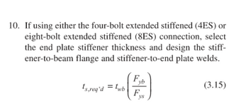

Below is a snippet from AISC DG-4 (on Bolted End Plate Connections) where they give some guidance on how to determine the stiffener thickness for an end plate stiffener. In this case:
tbw = beams web thickness
Fyb = Yield stress of the beam
Fys = Yield stress of the stiffener
There is also a section on preventing stiffener buckling.
I didn't think of checking through DG4/16/30? because I was kinda hoping that maybe I could treat this connection as a pinned connection... yeah maybe not huh? I don't know. This is part of a truss assembly so I was hoping I could treat these connections as axial only-ish. The eccentricities are kinda screwing up any hope for that. But for this exercise, lets pretend that it is. Either way Its a good idea and I'll look through it and see if I can gleam and ideas. Thanks
I agree, there will be considerable eccentricity between the axial load in your angle and the connection.
For all the faffing about with these little stiffeners, I'd be inclined to just scrap them and make the end plate a bit thicker.
I think that you can use @JoshPlumSE's suggestion of the AISC DG stuff though. Yes, those are intended for moment connections. But every moment connection is a combination of an axial tension connection at one flange and an axial compression connection at the other. You should be able to massage the provisions for the axial tension flange connection to suite your purposes. Or, at the least, you can if you ignore those pesky eccentricities.
