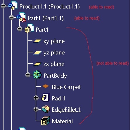

Hey,
I am trying to read the full CATIA hierarchy but not able to read some part of c++ API which is shown in the fig
I am using the CATIA selection function to read
code snip:
App = (INFITF::Application^)Marshal::GetActiveObject("CATIA.Application");
Documentread = (ProductStructureTypeLib::productDocument^)App->ActiveDocument; //(using productDocument not able to find alternative for part ???
Your question isn't about C++ as one could imagine, but about Automation API. Which is COM-based and thus the same for all languages.
So I suggest you to study Automation help, located in \code\bin\V5Automation.chm
As a quick hint:
Code:
ProductDocument doc = App.ActiveDocument;
Product root = doc.Product;
foreach (Product sub in root.Products)
  Product refPrd = sub.ReferenceProduct;
  Document refDoc = refPrd.Parent;
  if (refDoc is MECMOD.PartDocument)
    MECMOD.Part prt = refDoc.Part;
    // refer to Part reference in V5Automation.chm
