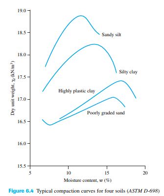

With water contents of 40-60% you are talking about a void ratio of 1-1.6 (assuming specific gravity of 2.67).

I think your contractor will have a very difficult time drying the material out to its OMC of 30%. OMC also seems etremely high for SILT and CLAY. See below.
