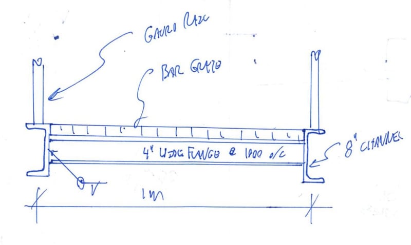

Gents,
I am looking into design principles of aprox. 1m wide walkways as follows: side beams are UNP profiles (expected size about UNP200) and transverse beams per 1-1.2m, either fully welded IPE80-IPE100 in the 'center' of the UNPs; the load, length and support conditions for walkways following these principles vary (e.g. one walkway can be simply supported 10m span, another can be 6m double spanned). Lateral stiffness of the walkways is intended to be achieved considering Vierendeel action, rather than the more common solution of providing horizontal bracing. Because length, support conditions (and thus bending moment diagram shape) and loads vary, at this point I am looking into opinions and / or literature related to a general case, so to say. What I am specifically interested for this general care are the LTB parameters of the UNPs in the described layout.

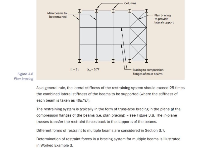

a) Apply the 25X guideline from your SCI document (may be difficult at 1m width), shown below AND/OR;
b) Figure out what strength and stiffness you'd need from a true plan truss and achieve those same parameters with your vierendeel truss.
Developing composite action between the two beams really is quite an elegant solution. It effectively steers the situation back towards [Iy > Ix therefor AOK].

Is this right? For a 10m span? I had to google all of the size as they were literally and figuratively foreign to me.
As for twin mode LTB on the channels, there's zero chance of that at these proportions based on torsional bracing alone. Your system warping torsion resistance will be way to great for that. Any vierendeel benefit will just be an unecessary bonus. I think that you can call your unbraced length the distance between the cross frames and call it good.

2) Use your vierendeel truss as a bracing system in place of more conventional, trussed, plan bracing:
nailed it. flooring is grating indeed. sections used in the post are indeed european...i have to converse units when reading this forum all the time, so ha! but yeah, so for these section sizes you would expect the critical length to be the length of the segment between transverse beams? what happens when the proportions start changing? i could see the side beams going to 300mm height (for other reasons such as serviceability), but not much more than that.

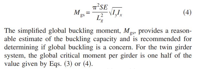

In the thread that retired13 sent you to, you will find the snippet below which provide a quick and dirty method of evaluating if global LTB is worthy of more detained consideration. I'd personally start with that and then only dig deeper if that check indicated a problem.
