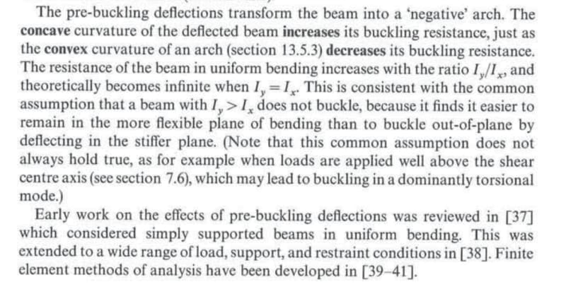

Thanks to Ingenuity I picked up a copy of The Behavior and Design of Steel Structures to AS4100. See a few excerpts below where it discusses some factors left out in design as well as the exact issue under discussion here. As Steve suggests the limit of Iy approaching Ix ---> Mcr = infinity > Mp and hence does not buckle.

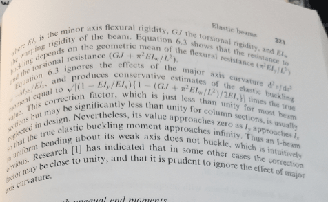

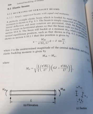

Thanks Enable. And of course Trahair covers it...
This is from his other book that is focused on buckling:
Nice!
steveh49 said:
I still find it odd that this is almost unmentioned in books (if correct) as it shows mathematically that LTB doesn't happen for minor axis bending. Never seen the maths behind it before.
I agree, this would seem to be exactly that.
