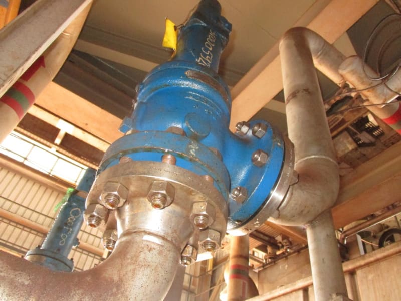

Hi guys,
Why do lube oil piping has seepages from flage connections. How to prevent these kind of seepages.
Thanks in advanve.
Why - Because the joint hasn't been installed correctly or the bolts tightened incorrectly
How to prevent - Do it properly and use correct (new) gasket on clean flanges and tighten bolts in correct order to correct torque in stages.

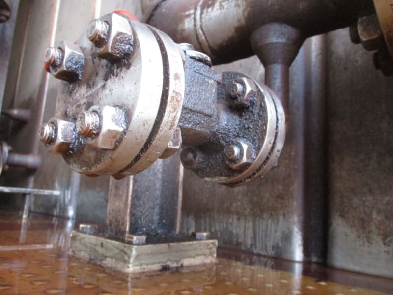

These lube oil lines are for the compressors. Sizes are differing from 1" to 8".
Some lines are carbon steel and some lines are of stainless steel. ASME rating Class 150. Operating temp ambient to 100 deg C.
Around 20% of the flanges were noted with minor non continous seepage as in the above photos.
I think this is due to damaged gaskets and with inadequate toquing of flange fasteners.

Often the issue is one where like this example the blind is removed from time to time but note one uses a new gallery or cleans the faces properly or torques it up correctly.
Lube oil seepage can be deadly on smooth surfaces and slips increase risk to personnel hugely. I would play the safety card if you want anything done.
