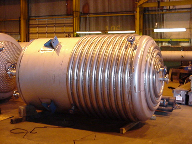

Here are some pictures that may prove interesting:
("Chemical half pipe jacket" photo)
Some fabricators seem to "skip" the half pipe coils at lugs located at the top of the shell.
Sometimes a "full supporting ring" is incorporated into the design...
Having fewer turns of half pipe simply means that the heatup/cooldown time increases very slightly....
Please respect us on this forum.....Let us know about your final decision and how you came to it...
Best Regards....
MJCronin
Sr. Process Engineer
"Having fewer turns of half pipe simply means that the heatup/cooldown time increases very slightly...."
Exactly; and that is just 'theoretical'. Very few, if any, process reactors are operated with liquid all the way up the shell. Skip the half-pipe on the top 2-feet of the shell. Conduction will keep 6 to 10 inches quite warm, and the remainder of the top of the shell should be unwetted headspace.
