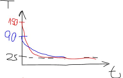

Still something is not clear for me:
If "they all come together at the ambient temperature" - then how the higher temperature drops faster?
(sorry for the bad drawing)
I mean - there are 2 points the graphs meat, but they all together only on the ambient temperature
The red line should always be above the blue. If not, there would be an error in the temperature reading, or calculation.

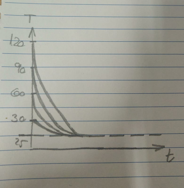

You mean something like this?
If yes then the 120C is slower but its drop is also slower than the 30's drop.

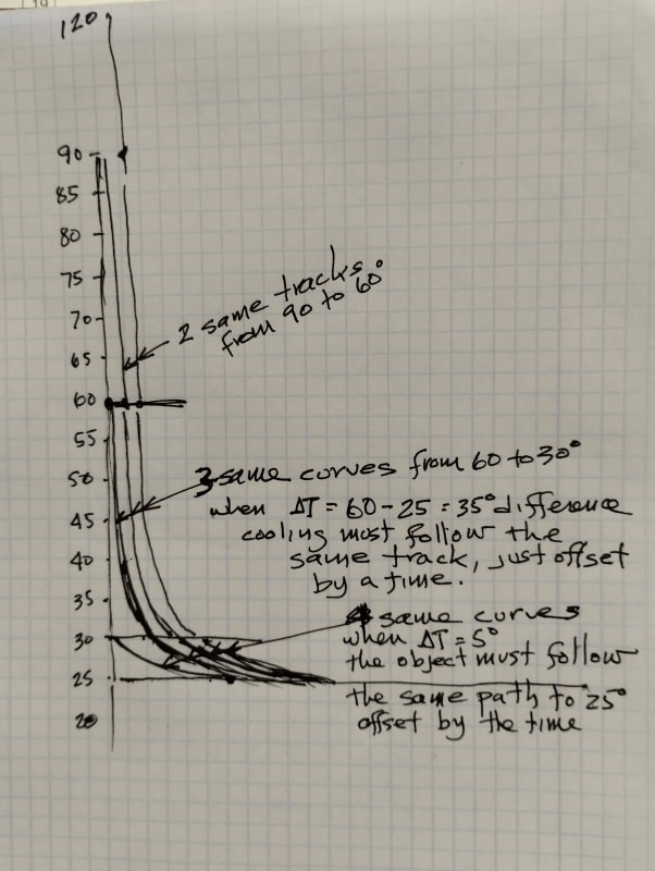

Pretty close! Except they don't all reach 25" at the dame time. Stretch them out a bit. The 120 needs a little longer tail. The 120 drops faster at the beginning, but later will almost equal the others.
When the 120 hits 30, its tail afterwards should look like the 30 curve.
All should fit together like that.
When the 60 curve reaches 30°, from thereafter it should look like the 30 curve.
When the 90 hits 60°, it should look like the 60 curve thereafter.
When the 120 hits 90°, it should look like the 90 curve.
Every cooling track is the same curve below any given temperature.
When the 120 gets to 90 deg, it follows the same path as the 90deg path to all temperatures below.
When the 90 gets to 60deg, it follows the same 60deg path to all temperatures below, which when it gets to 30 follows the same path for the 30deg track for all temperatures below 30.
